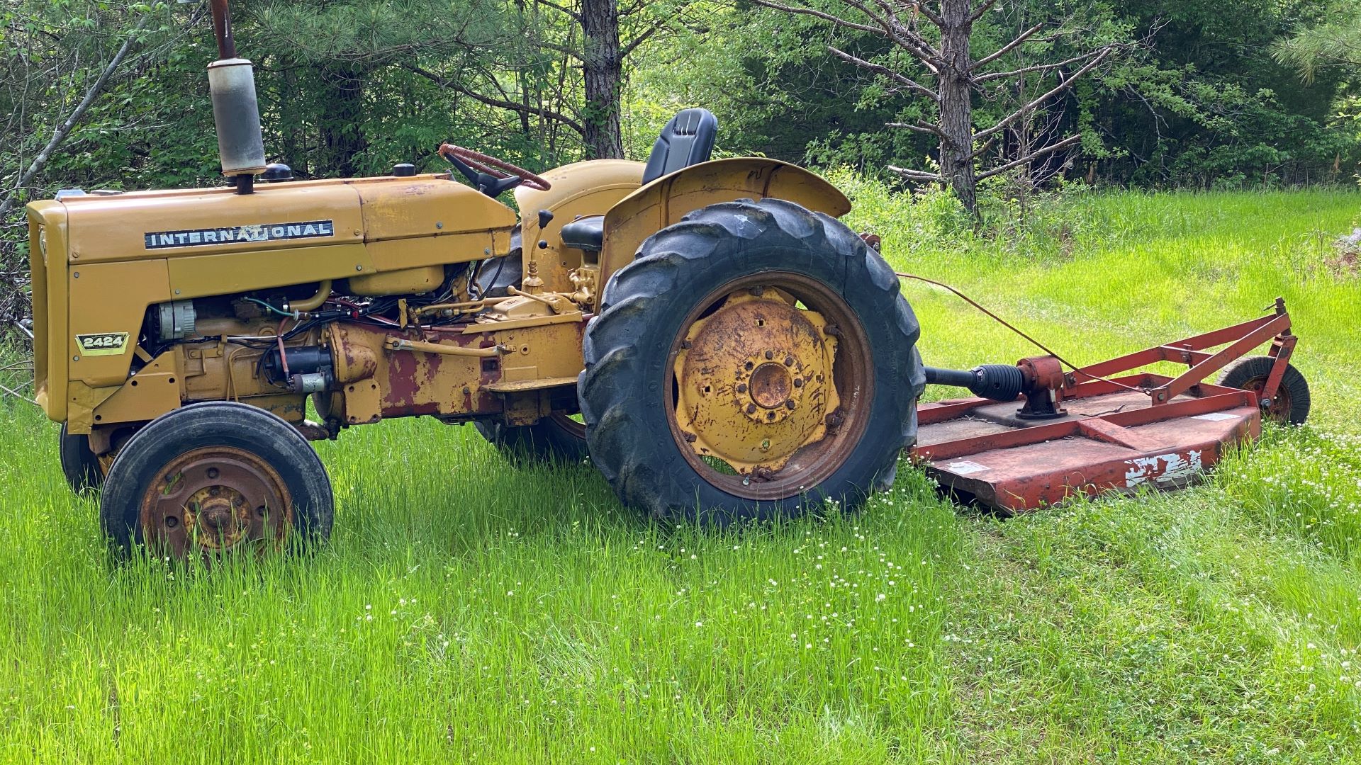

Well, yesterday I took delivery of the 2424 (and bush hog). Saturday my wife called while I was down the hill working on the old 2N to tell me that they just dropped the price to $2,500. I asked her if she agreed with me calling him and telling him I wanted and she said yes. He delivered it after work yesterday. I like it! Right now it will run for short bit then die like it ran out of gas. Let it sit a minute and it'll crank right back up for a sec. I'm sure the float is sticking. He had to take the tank off and clean it out and I think it is still getting some rust out. I think some more cleaning on the tank and carb and new filter will get it running normal.

I'm hoping not to beat it! I need to find an parking brake handle and grease everything. Clutch pedal is stiff and I have to pull it up with my foot to engage it. Brakes need to be freed up. When you press them they don't spring back. I expected these kind of things after it setting up.
I'll have to figure out what the 2 knobs do under the front of the seat that say Slow-Fast and Open-Shut are for.
ours did a similar thing would start fine and run fine but not for long and would starve for gas. FIL and wife's uncle chased several things, rebuilt carb, new fuel pump
turns out ours had 50 years of crud blocking/restricting the outlet on the bottom of the tank that the sediment bowl attaches to. cleaned that out and no issues since (still runs rich but haven't tinkered with that).
Slow-Fast, in Slow mode it reduces the speed of the 3PT lift by about one half.
The Open-Shut, should always be in the Open position, the Shut position if your tractor has a remote hydraulic outlet option.
Re clutch there should be a pull up spring attached to top of clutch pedal, I see the spring in your photo, there are also grease zerks on both ends of the clutch shaft and there is an inspection plate that can be remove on the bottom of the torque tube just behind the flywheel to inspect the pressure plate and clutch throughout bearing. The older models had a grease zerk on the throughout bearing carrier.

Re Brakes, see link below but I believe on the 2424 the Park Brake Lock maybe on the right side of the transmission close to the brake pedals.

I've had my 2424 for almost 40 years and will never part with it. They are an extremely rugged tractor due to the industrial design - heavy duty front end to support a loader and wide stance on the back. These were IH base for backhoes back in the 60's. X2 on crud in the outlet. I had similar problems long ago and turned out there was a chunk of wood - maybe golden rod stem about 2' long in the tank - been there so long it was waterlogged and would occasionally end up blocking the outlet.

Hello again. I had a chance to spend time with the tractor yesterday and it was obvious that the float was sticking. Took the carb apart got it all cleaned and runs much better, until the line clogged up. There’s no room for a sediment bowl which has a screen that sticks up into the tank. Is there any kind of screen that screws into the tank and just has the threaded female side on the bottom to screw in the fuel line adapter?

Check parts on this site, strainers that go in the tank and one that screws into the carb inlet

My 2424 has a sediment bowl, but not at the bottom of the tank. Its located close to the electric fuel pump.
