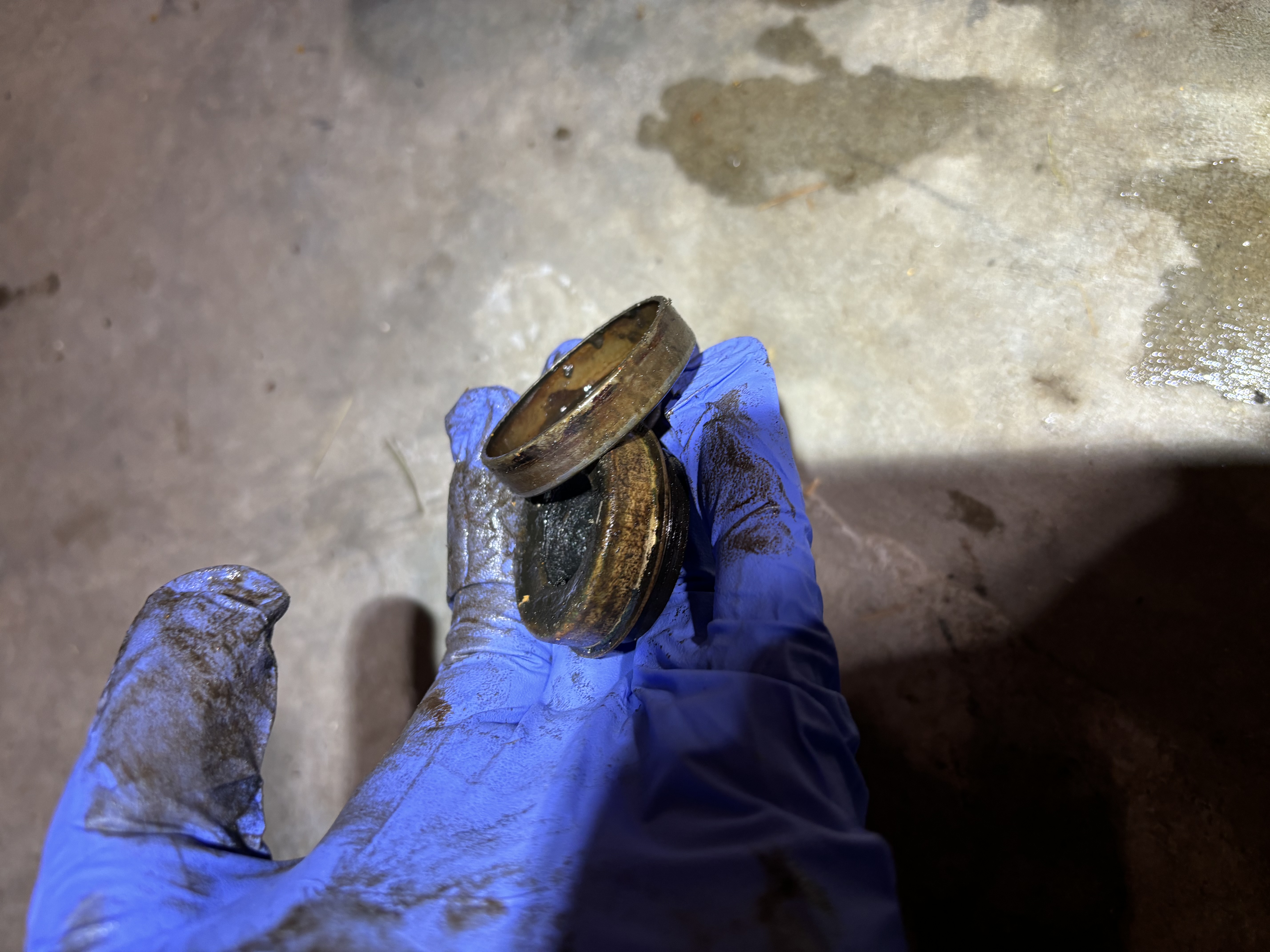

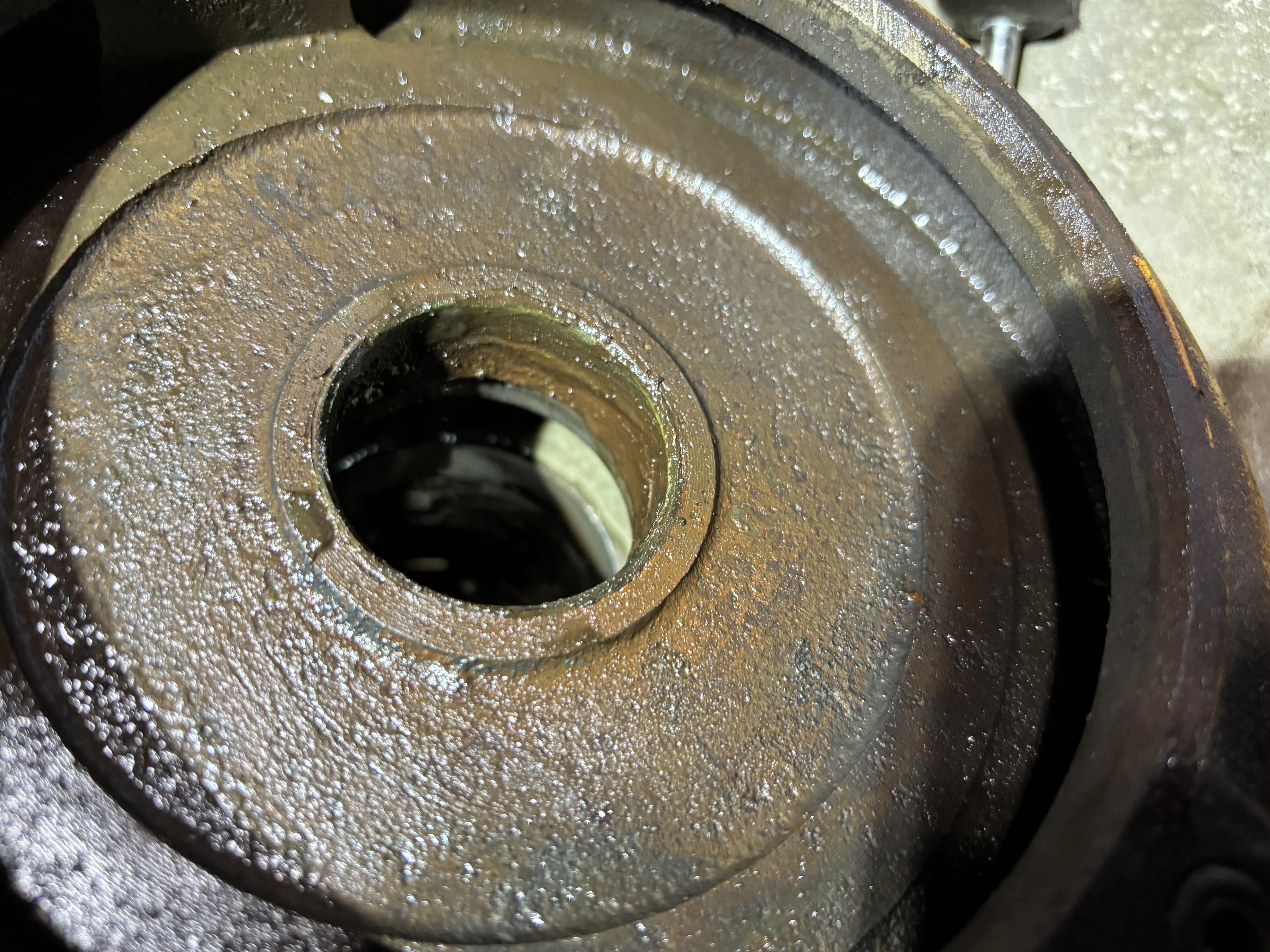

Soooo… the water pump is off.

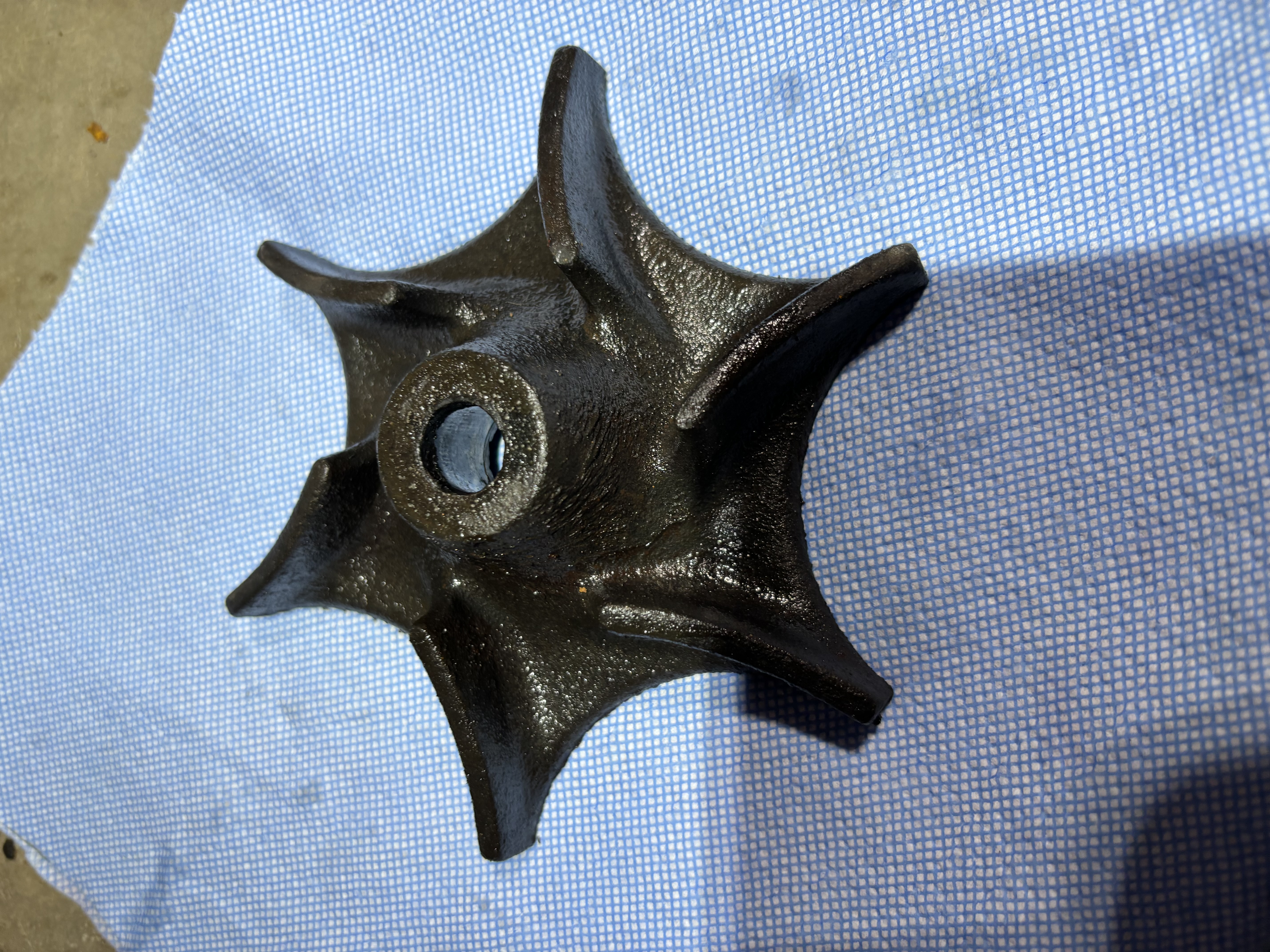

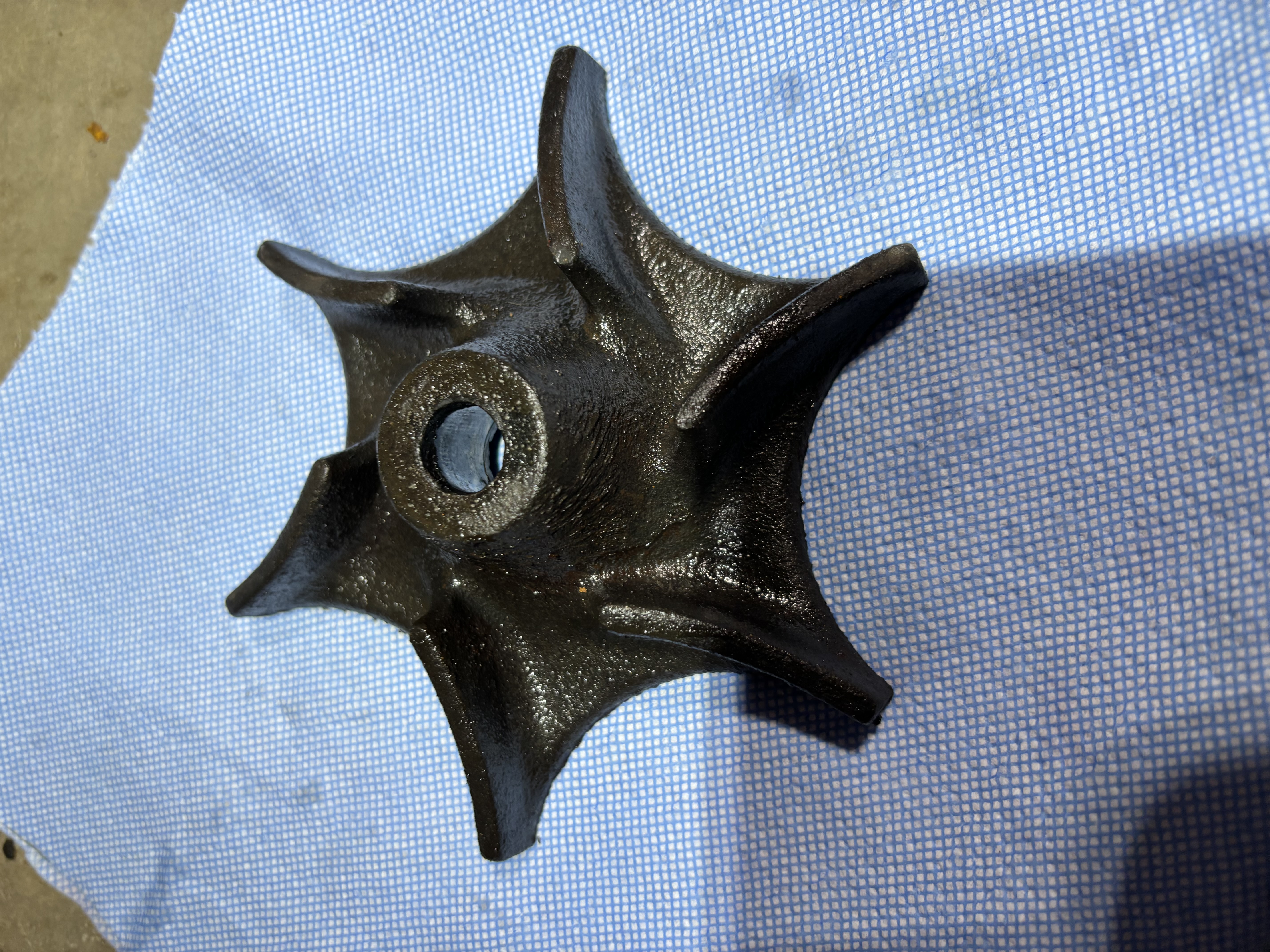

What do you guys think about the impeller? It looks good to me but I have nothing to compare it to.
IMO, the oil seal “behind” the impeller failed. The oil in there looked contaminated with water (it’s milky) and plenty of rusty gunk behind and in this seal. The two (?) bearing don’t look to too bad.
The bolt that holds the impeller in place wasn’t loose but it also wasn’t super super tight, so maybe the impeller slipped?
Is the impeller keyed to the shaft? Is there anything to limit the impeller from slipping on the shaft? The impeller itself looks good in that picture. How's the end play?
No it’s not keyed to the shaft. It’s just bolted on the shaft. So beside the bolt, there is nothing that limits the impeller from slipping on the shaft. There could be a tiny tiny bit of end play.

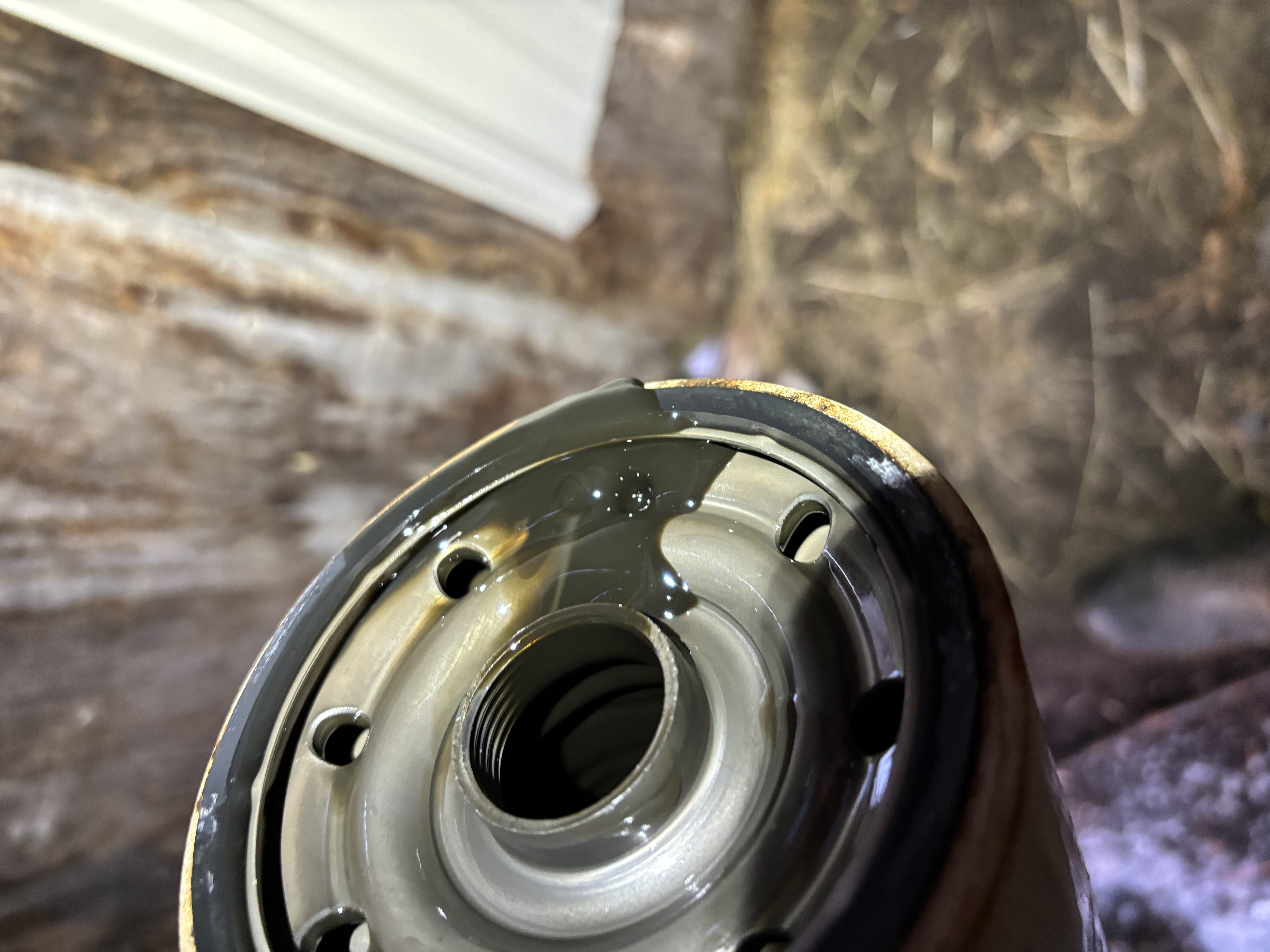

That's ok, next engine warm and on low idle remove the radiator filler cap, (protect your hands), watch the coolant for any sign of air bubbles coming up through it, how is the oil is it clean and the level not rising, do you know if it's a 3304 engine it has, is it manual or power shift.
AJ
AJ
No air bubbles when warm.
The oil is dark brown and the level is not rising. No oil in the water or water in the oil.
As far as I know it’s a 3304 engine with power shift.
Yeah that seems fine you could sample it for 14 bucks just to make sure at caterpillar see if there’s any water or ethylene glycol in it
Your problem is more than likely the same problem as why the machine was parked in the first place, there has to be a reason it was parked, those were great dozers but were prone to the liners coming loose and the heads cracking should they get hot and have cold water poured in. have a Cat mechanic look at it for you..
