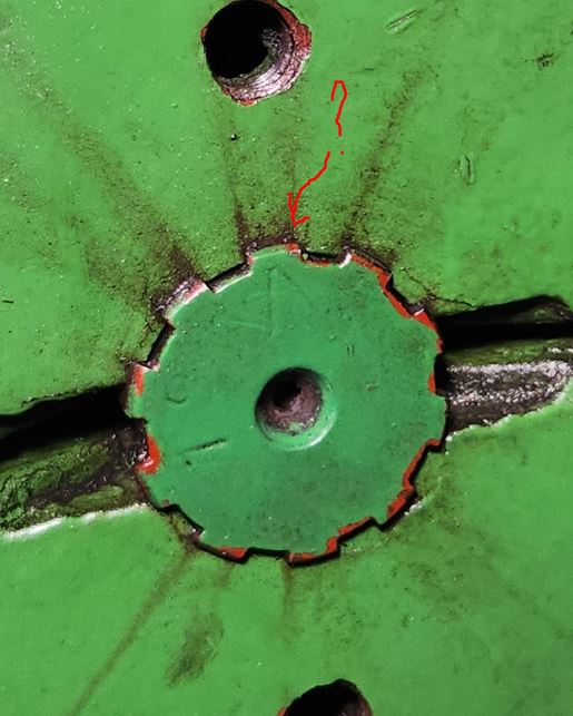

I'm having fits with JD H. It spits, sputters, coughs and farts. Carburetor has been rebuilt.
To get the Impulse to fire at TDC, and have the magneto lugs horizontal, I had to skip two teeth from where the timing marks are.
I removed the cover on the engine and the camshaft/crank timing marks match up.
Also, it seems that when the LH Exhaust valve starts to open, the mark is lightly past the mark on case. I assume the small indent is the correct mark.
I have the impulse timing set between the 1st and 2nd mark, which I believe is correct for 6274.

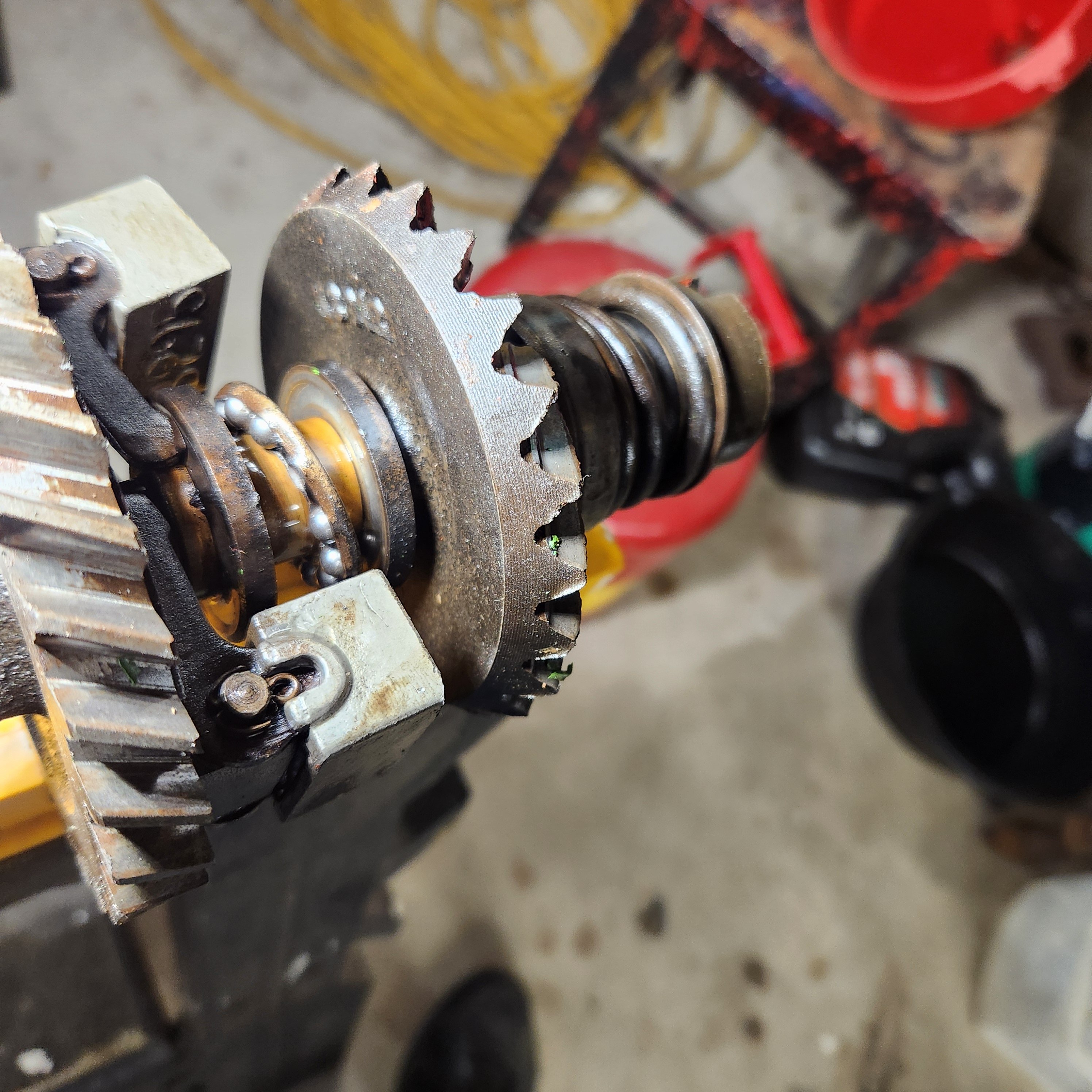

Jim - Do you think my flywheel is off one tooth? I stuck a camera down the spark plug hole and I could see the piston to find TDC. I put a black mark on the flywheel aligned with the mark on the cover. I am pretty confident in that mark.
Your flywheel is timed to the crankshaft correctly – the “V” on the crankshaft should point directly toward that threaded hole on the flywheel, and if you remove the paint on your flywheel, you’ll find the “V” on the flywheel aligned with that of the crankshaft. And in the second picture you are only a few degrees away from the LH EXHAUST OPEN markings and that might be because of cam wear, loose tappets, or other factors, but it proves the cam is timed properly to the crankshaft. And the impulse stop is set correctly for the 6274 drive cup.
However, what is very disturbing is the remarkable twist of the end of the exposed governor shaft. Those splines should be straight. That indicates that a Power Lift had locked up resulting in twisting that shaft. And this is just a guess, but such trauma might have sheared the key between the governor drive gear and the governor shaft. The governor drive gear is a press fit so it would grip the shaft even though the key may have sheared, but that might explain the reason why your magneto drive flange slots aren’t horizontal when they should be….

Here's an exploded parts view of the pieces in question. If the key between the governor shaft and the governor drive gear had sheared and the governor drive gear rotated out of phase somewhat, that could be the reason your magneto drive flange slots aren't horizontal - but again, that's just a guess. But I agree, you should pull that unit apart and inspect for damage. The gears and the magneto drive flange are a press fit to the shaft and can be difficult to press off, but heating those items with a torch while pressing them off will help a lot.

Agreed, I found one like that at a flea market once. Didn't buy it of course. But that alone wouldn't affect the timing unless the key in the gear is sheared.
