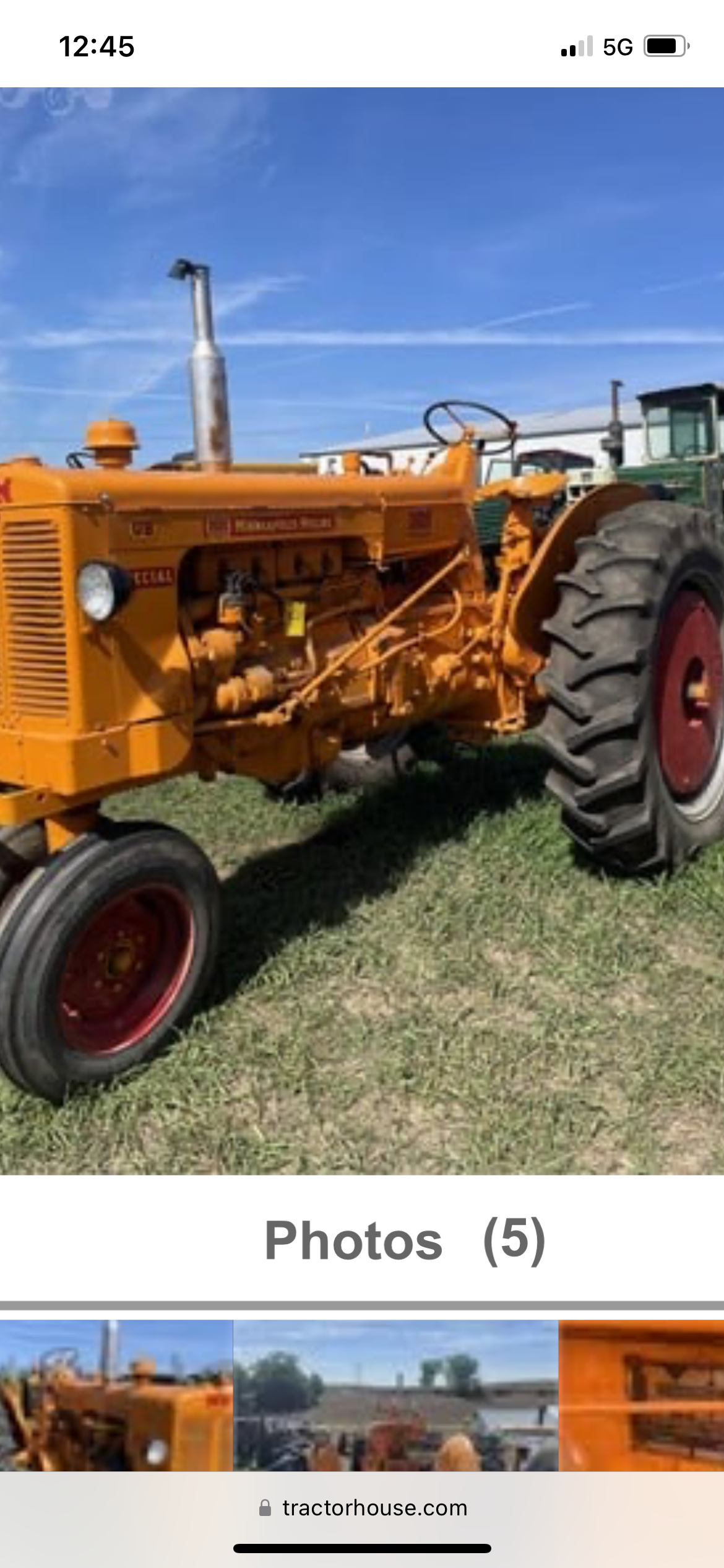

Will vary if gas diesel or lp. My diesel is same as in this picture except would have diesel on tank. MM on back of seat.

Mine is a gas. Judging from this picture it looks like the Minneapolis Moline goes kind of over the manifold, with the UB in front of that and then the Special on the fro of the panel. I think maybe there is an MM that goes on the gas tank?

Don't think MM on tank. Have to check on an original.

No MM on the fuel tank. That was stopped several years earlier, defiantly before the UB special.
Okay, this is good information. So, nothing on the tank or does something else go on the tank? Does the rest of it look close?
