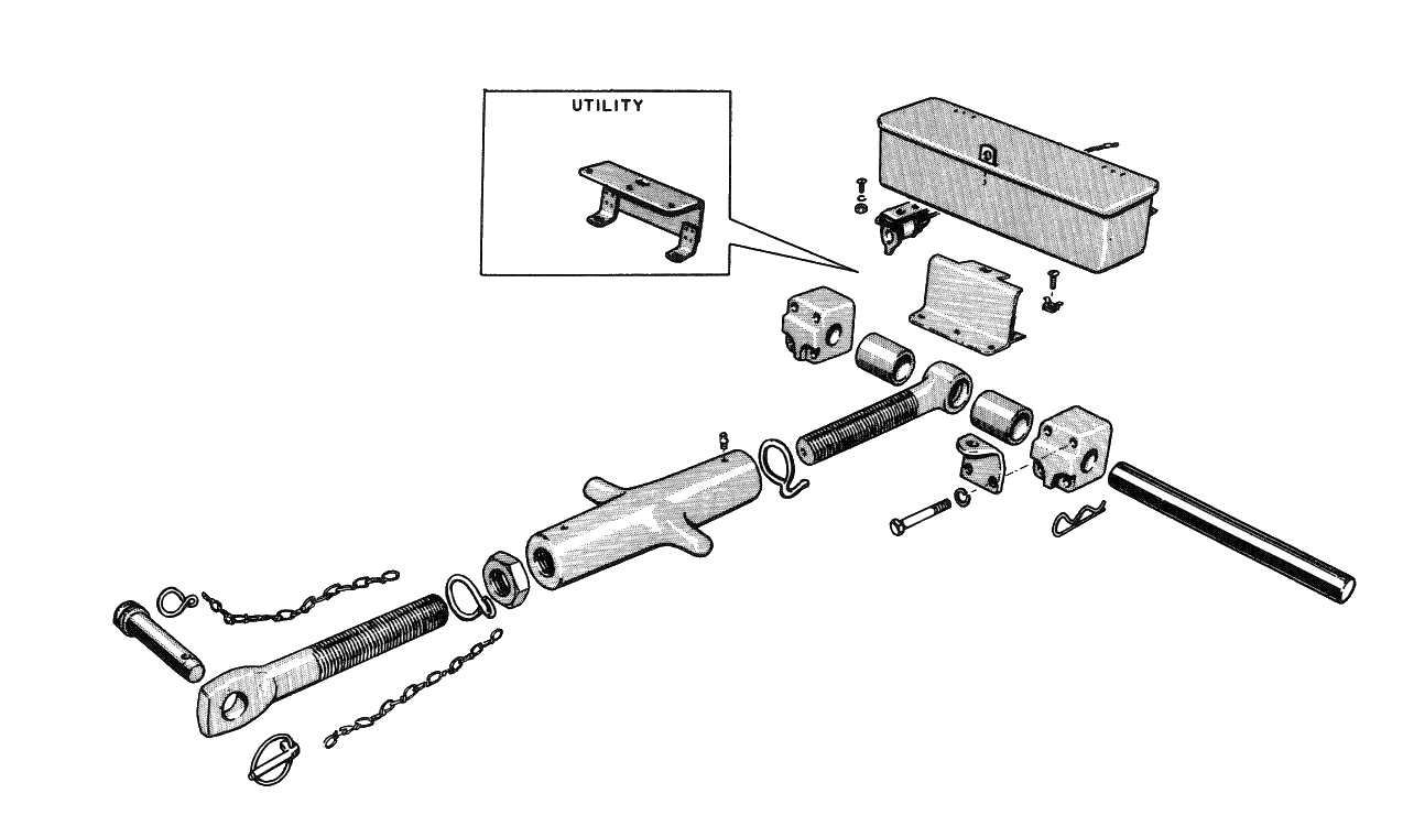

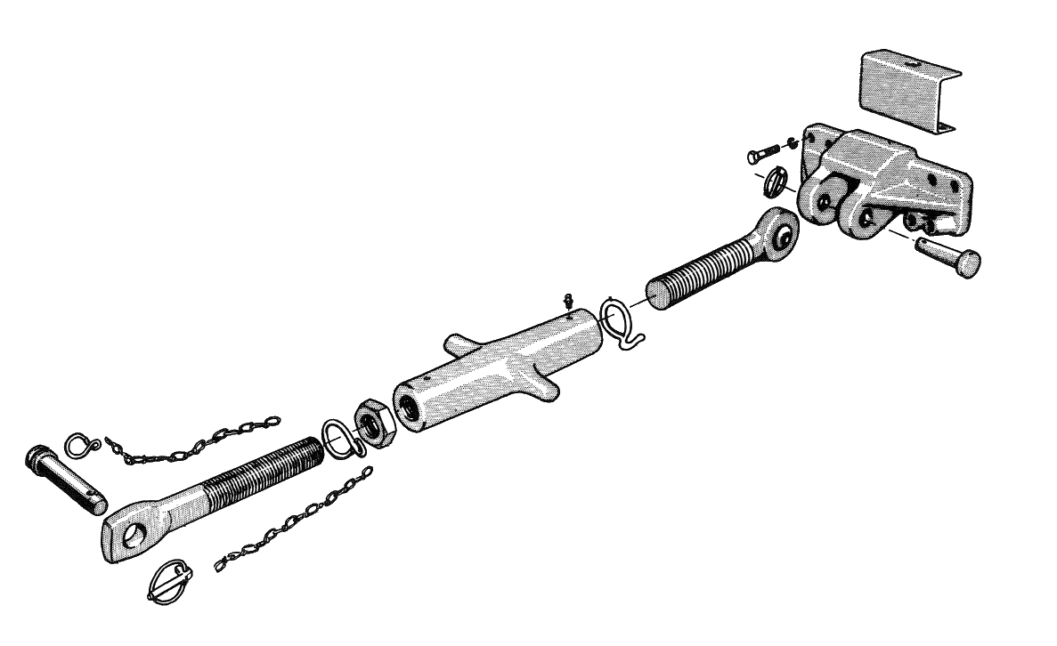

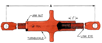

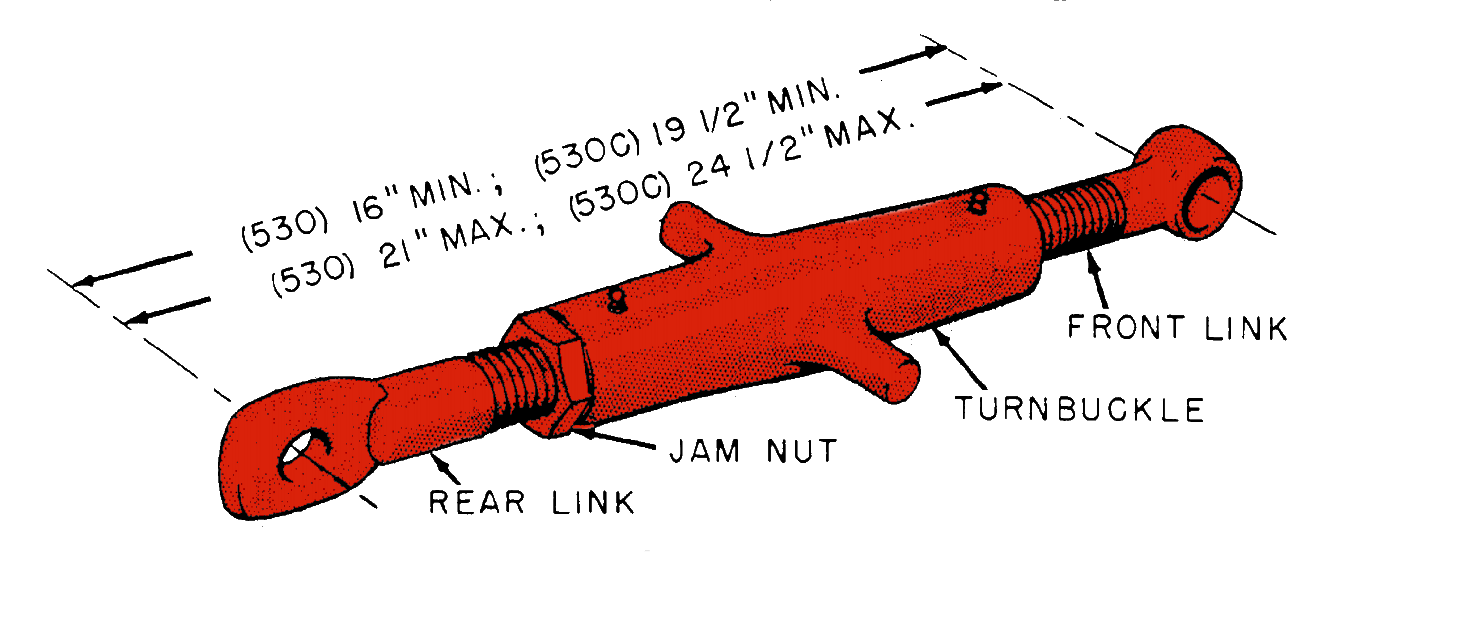

The second one is for a VAC. All others are for the 300 but the VAC and 300 are the same length and use almost all the same components except for the anchor eyelet which they changed (I assume) to make it stronger?
