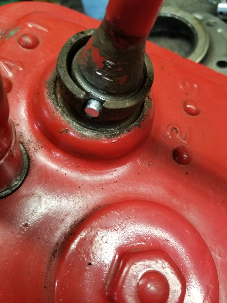

Isn't that the truth. I also had to replace the shifter pin when I pulled my friends cover last week. Now that was a "fun" project.
@Dan - I am going through my "new" '48 8N. The shifter pin was worn to about 1/32" wide where it fit into the slots. I also found the retainer for the spring underneath was about completely worn through, as well. A chore to get that retainer out! Pin came out easily with an appropriate BFH and a punch.
Aren't these tractors fun! zuhnc
Came out easy?!?! Some people have all the luck! Mine was as worn down as yours (original pin) and would not budge! I had to drill all the way through (by hand and still stayed 100% inside the pin) and a BFH to get mine out. Good for another 75 years or more
