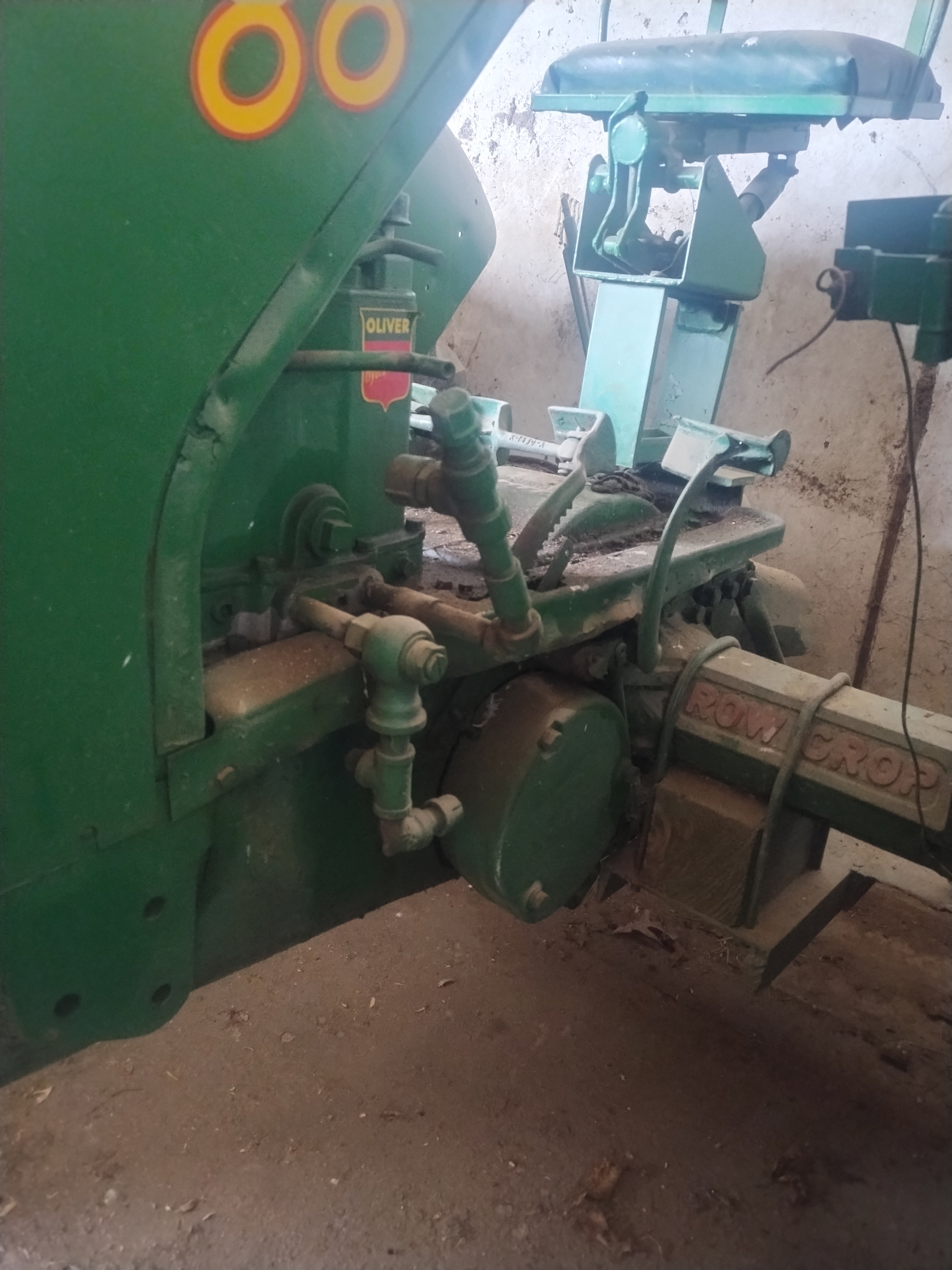

What is that clamp on the front of the fender for?

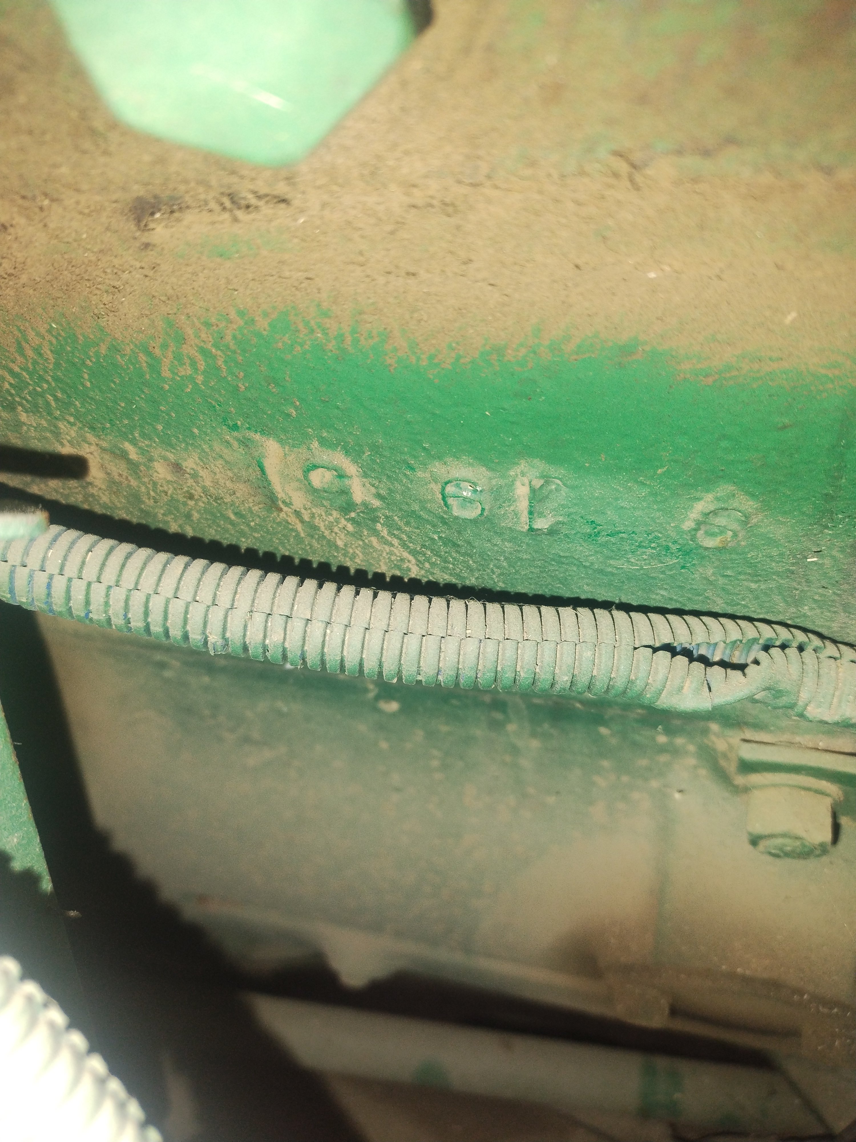

Are there any letters/numbers after the serial number?
